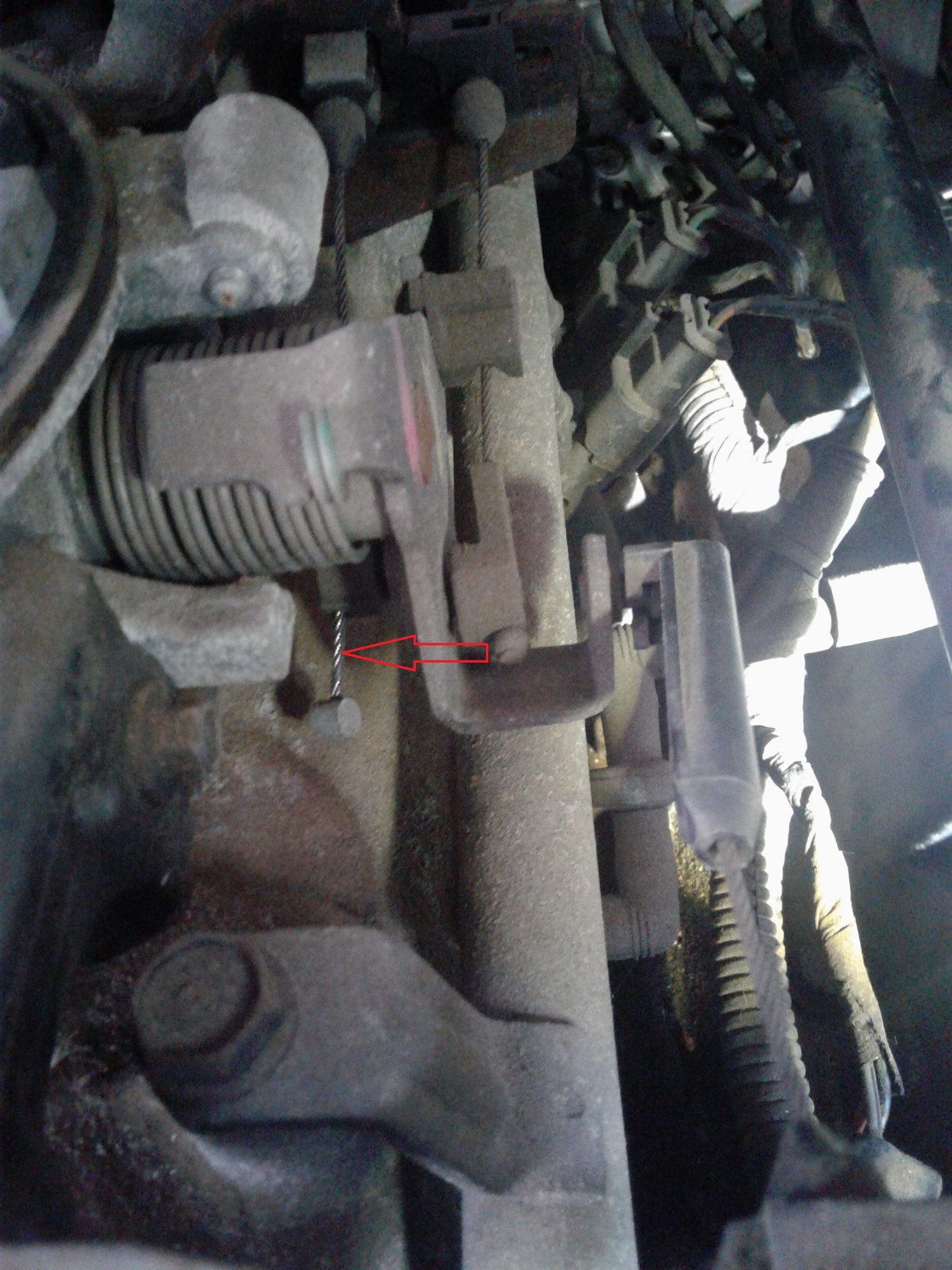

Does this look right in the pic, when I press on the gas this cable doesn't do anything, should it be moving also?

I think the cable your arrow is pointing at, is for the cruise control. (cable from the servo.)

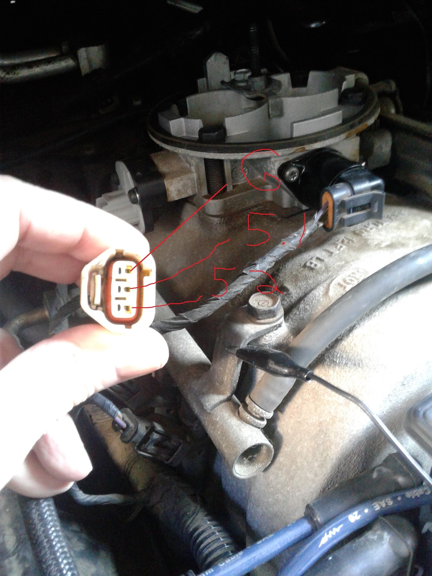

Check voltage from the throttle position sensor. Should start out below 1 volt, and climb smoothly as you open the throttle. Analog meter is best for this test. The digital fellers don't react quick enough.

I did replace it, the crank sensor, and Idle Air Control Valve, should i check it anyway?
That test is done with the engine off and by pressing on the gas peddle slowly, is that right?

Yeah, I would check it anyway. Make sure it is getting the proper 5 volt reference signal, then see what the numbers look like.

I did the test, I turned ignition on, you can see one black alligator clip next the the TPS plug i put on the motor maybe not the best ground, I probed the plug and got 2 voltage readings and a ground, one was 5.1 volts and the end pin was 5.2 volts, shouldn't I only get one voltage reading?
