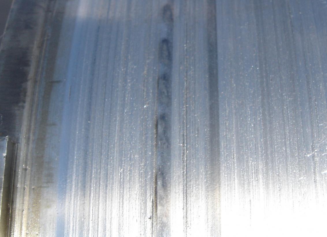

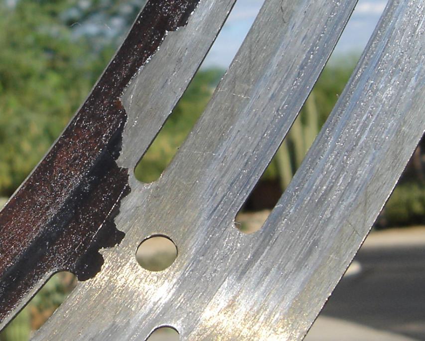

When I took the tranny apart, I found that the Direct drum was ground down by a bare band, metal to metal contact gouging the Direct drum hence the metal dust in the fluid.
Question - When I pulled out the accumulator there was no Inner Spring as referenced on page 518 and 538 of the FSM. When I look on the WIT website it does not show an Inner Spring for the accumulator although it shows an Outer Spring....I assume there is an Inner Spring to the accumulator correct?
When measuring the input shaft endplay (which was in spec), I noticed that the input shaft had 65 thousands of side to side wiggle play.....is this normal? maybe due to the Direct Drum band being loose? The bushing did not appear to have abnormal wear.
Thanks for the help

Originally Posted by jamjet
Thanks for the help Monte.
Thanks for the help
No inner spring.
The wiggle is because the input shaft is supported by the converter. It is normal for the input shaft to wiggle back and forth.
