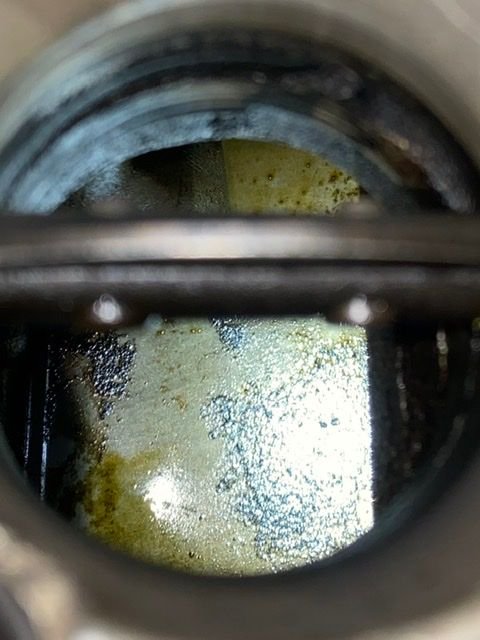

Default Lake of oil.
Well I have my new water pump, fan clutch, cloyes double roller set, timing cover gasket set coming.
I also ordered the Hughes felpro plenum Kit. I also got the stuff for a tuneup including 3923 plugs while I’m at it. Mileage is around 11.3 no load combined in town and highway. 10.6 with travel trailer mostly highway in direct drive OD off.
I have a lake of oil in my intake, it has certainly gotten much worse than it was. Currently 188k on it.
I will update here after repairs are done
Phone camera doesn’t catch it well but there is much more oil than it appears in the photo.

Yeah, that one is blown. May wanna consider replacing the O2 sensor as well.
