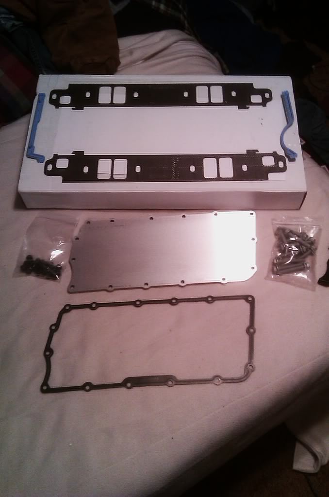

I ordered the APS Precision kit, do you guys see anything else i would need other than all this?
It came with the Mopar gasket
Also, what code did you get roger_groom? Mine threw a P0441 for incorrect purge flow because i accedentaly broke the line that goes into the firewall on the ECU side underneath the harness, i repaired the lines and the code didnt show back up that i know of
