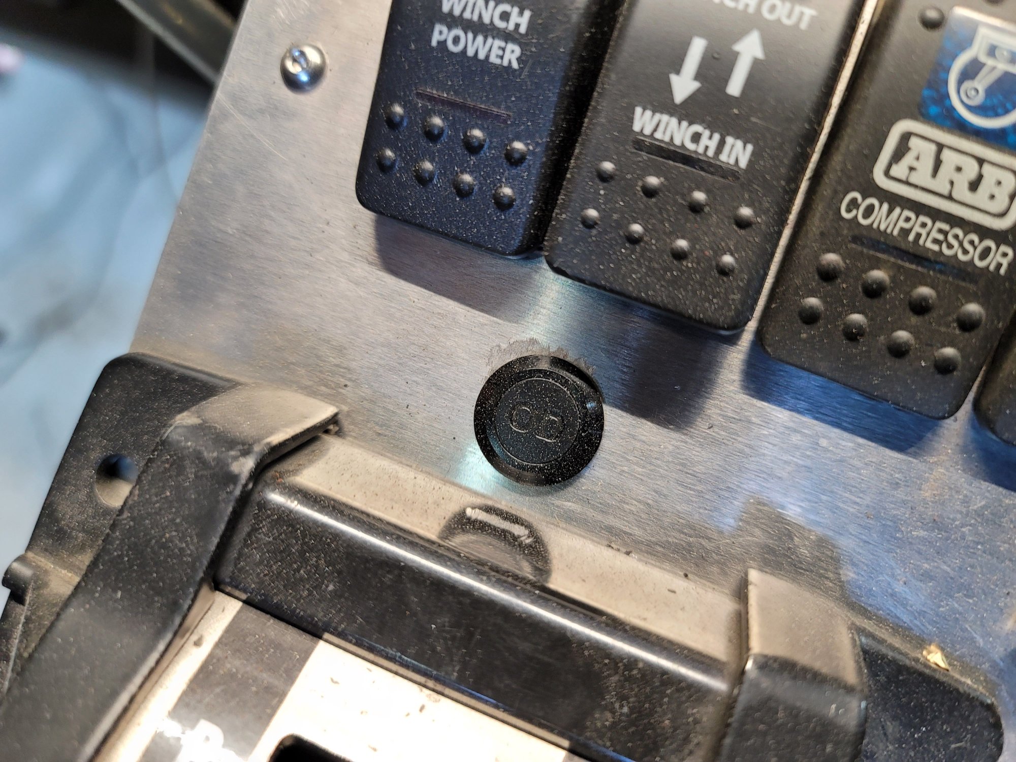

PCM already has that capability. At least, it should be easy on a 96-97 PCM, on the 98 and newer, the PCM just tells the cluster to turn on the O/D Off lite... The older PCM will have a couple pins for that light, which on the older trucks is integrated into the switch itself.
Dang Nab..... I think my PCM is from a 1998 if I remember correctly. I can't use the 1997 PCM as it won't talk to the dash of the Jeep. It'll make the engine run but my 1997 Jeep Wrangler has a CCD dash so it has to have a PCM that will communicate in the CCD. I was hoping to figure out a way to make that light illuminate. Even if I had to use a part of dash to decipher the signal.
Guess I shouldn't have drilled that hole until I verified I could make it work.

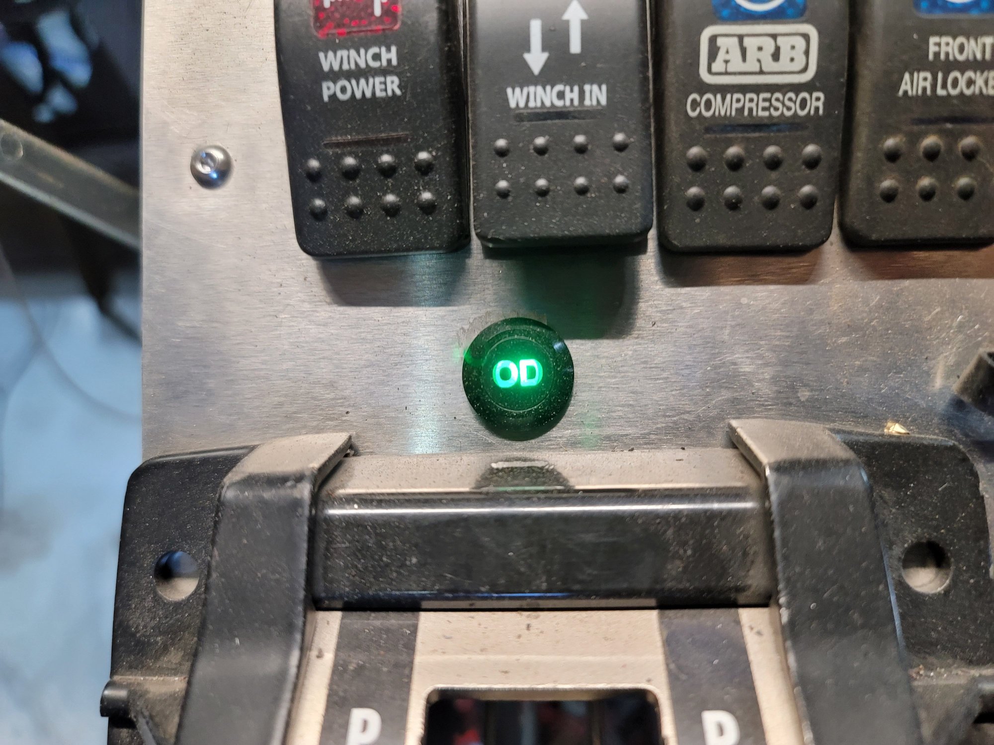

Took me a little research and looking around at different electrical forums and found the information I was looking for. Basically I needed what was called a self latching relay to turn the O/D light on & off when I selected to turn off the O/D. So I took a chance and ordered a relay off Amazon. Got out my jumper leads and made some short leads to hook things up with. This was just to test the theory and I'll be cleaning up all this once I'm done.
But I NOW have a O/D light..... YaHoo
Confirmed by the SnapOn scanner
And yep it works when turning off.
I'm happy with myself and the fact that I was able to figure this all out.
Old Jul 13, 2023 | 02:27 PM
  #983
Posts: 87,482
Cool. And the lite is even labeled properly. Awesome.

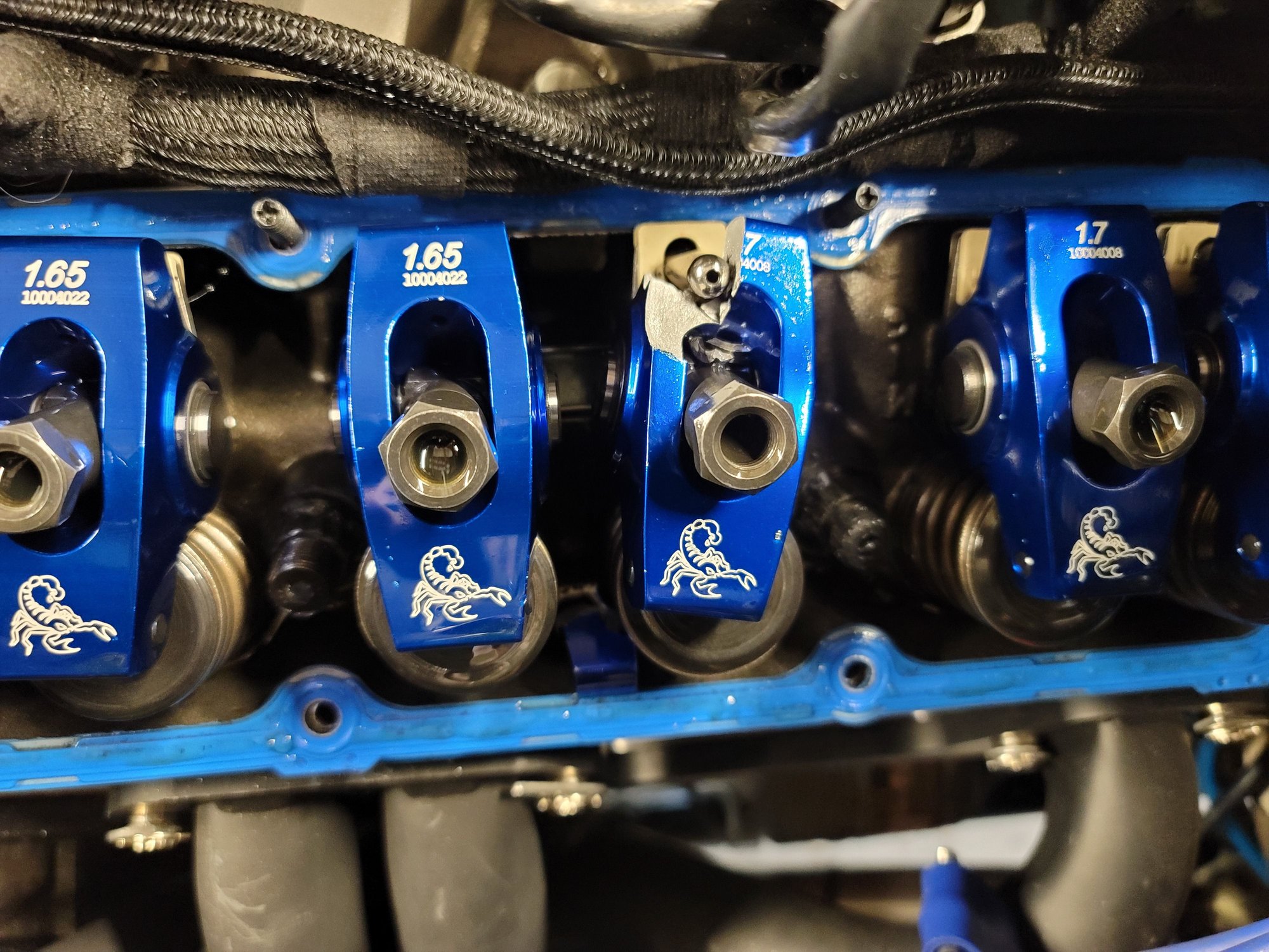

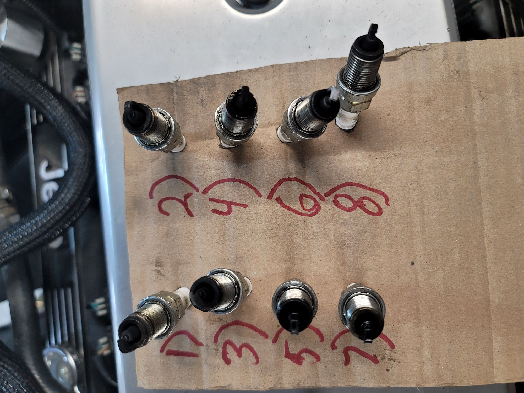

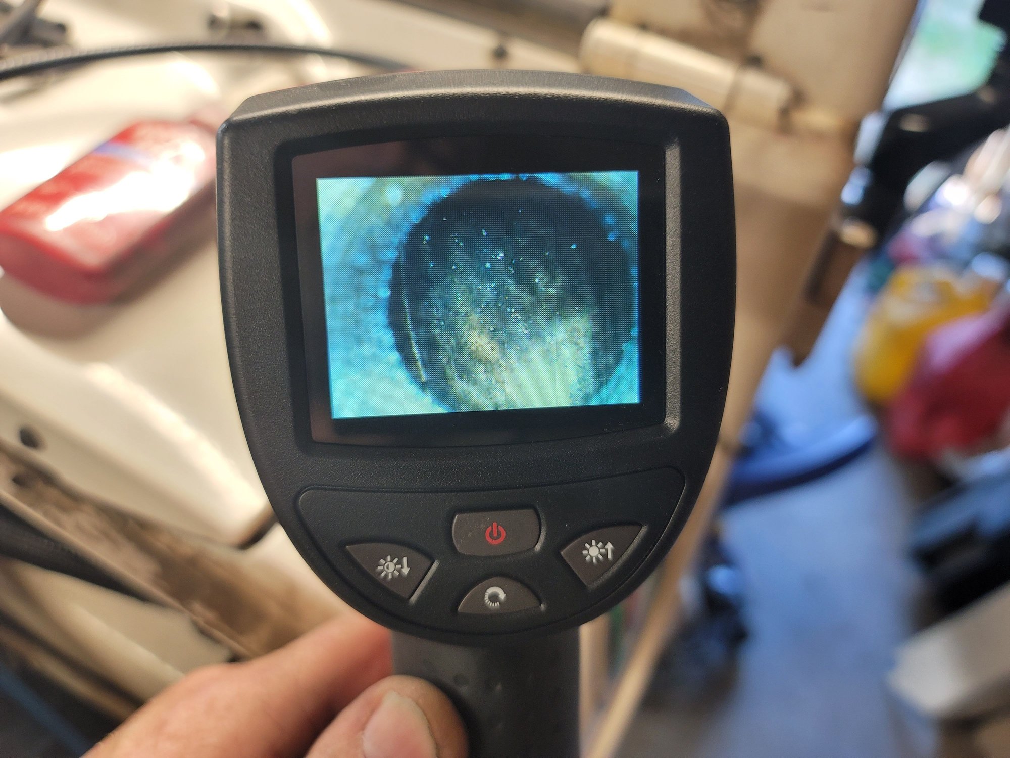

Pulled the spark plugs so I could do a compression test on the engine. Yep it's running pretty rich.
Compression test wasn't what I was hoping to see.
Leakdown test showed that things looked good in the cylinder.

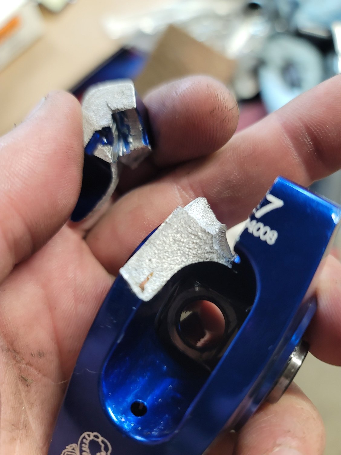

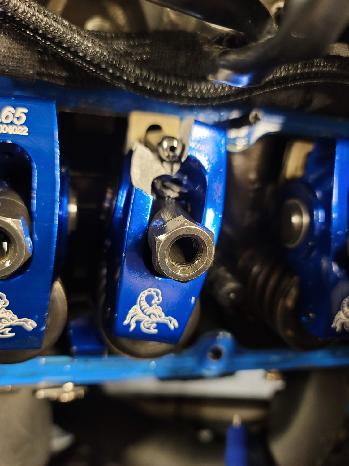

Pulled the drivers side valve cover and this was what greeted me.
Not sure why or what caused this either.
But it's broken
Got out my bore camera and piston looked good.
Got a new rocker arm and rocker stud ordered. Push rod rolled on a flat surface was fine. The stud doesn't look bent but I'm going to error on the side of caution.
Old Jul 18, 2023 | 03:57 PM
  #990
Posts: 87,482
Wow. Yeah, way rich.... but, I don't think one broken rocker would account for that. It WOULD account for the stupid low compression number though. The rest look good.
