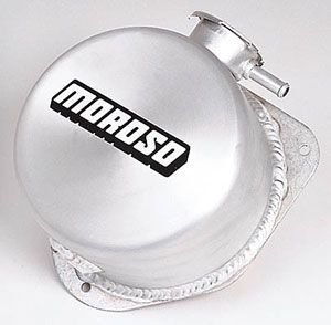

So how would I go about hooking this up to my radiator. I could mount this higher if I could find a place for it.
http://www.jegs.com/i/Moroso/710/63650/10002/-1
Old Jun 20, 2015 | 05:04 PM
  #478
Posts: 87,479
Your radiator is designed to have a pressure cap on it though...... If you could find a radiator cap that just sealed the opening, ABOVE the overflow port, then it would be just a matter of running a hose to the additional tank. Bear in mind, that hose will now be under pressure, so, use hose that is rated for it, and two clamps on each end. Then, that tank becomes your fill-point for the radiator.
