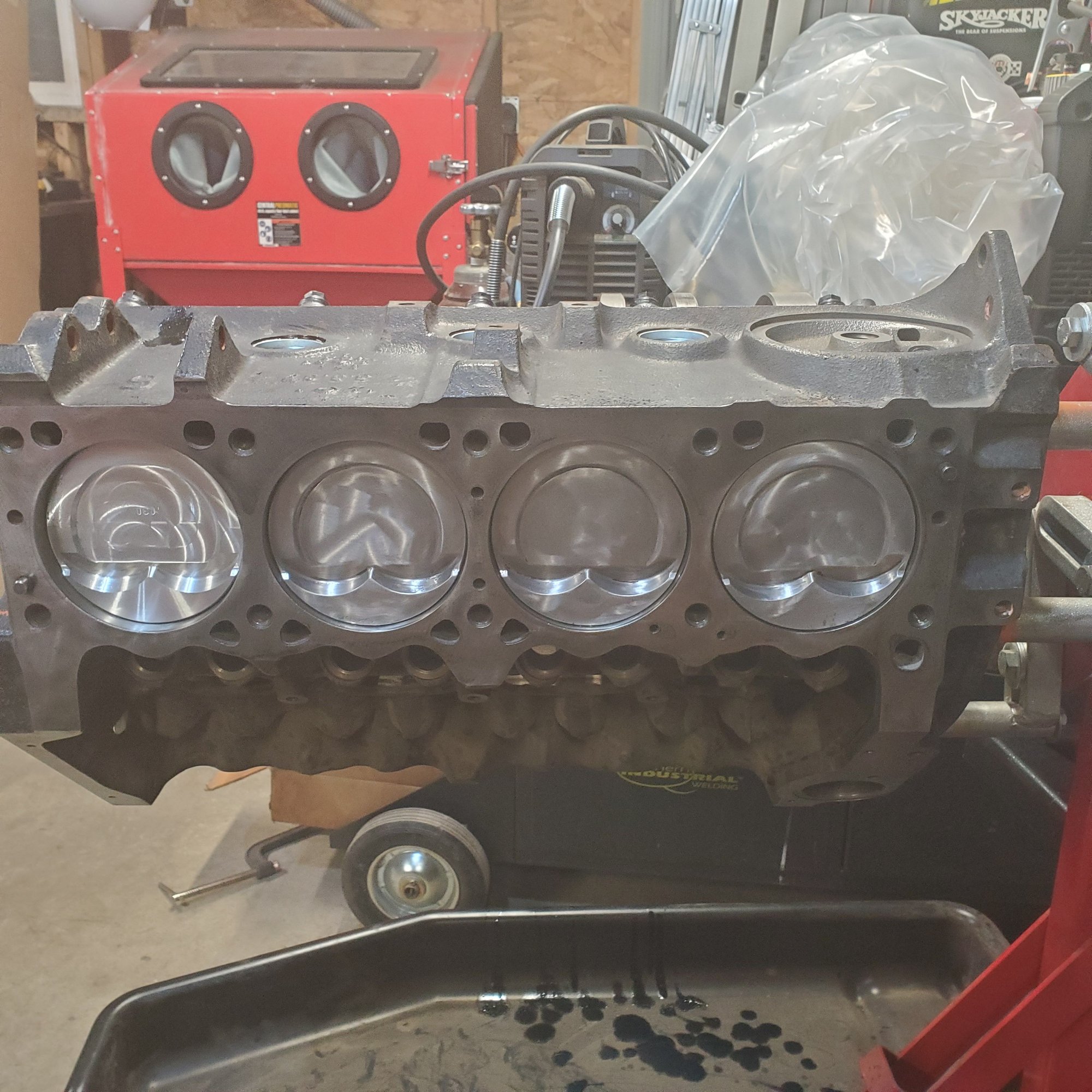

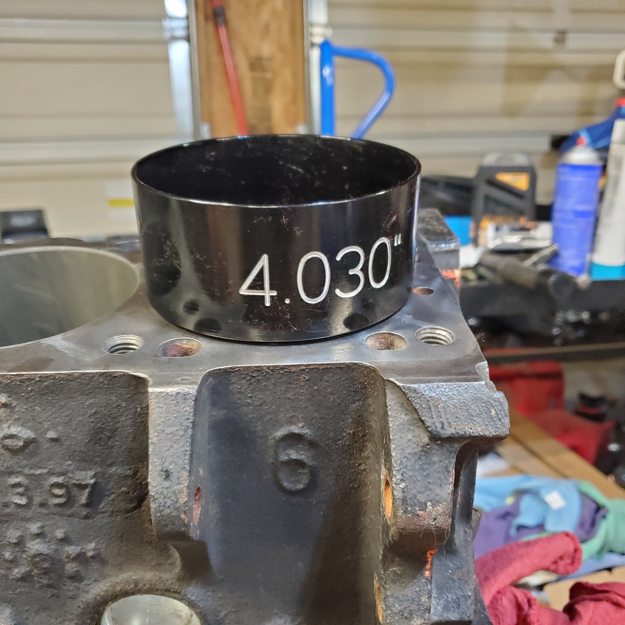

So I started off the day installing the pistons. I'd already gone thru all the pistons and checked to make sure the piston rings were clocked properly so that part was done. So now it was time to drop the pistons into the cylinders.

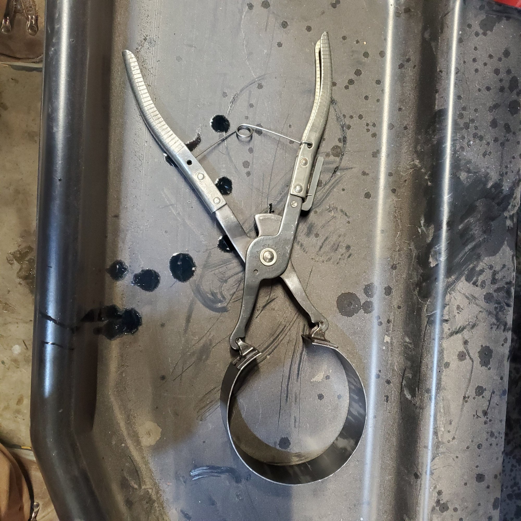

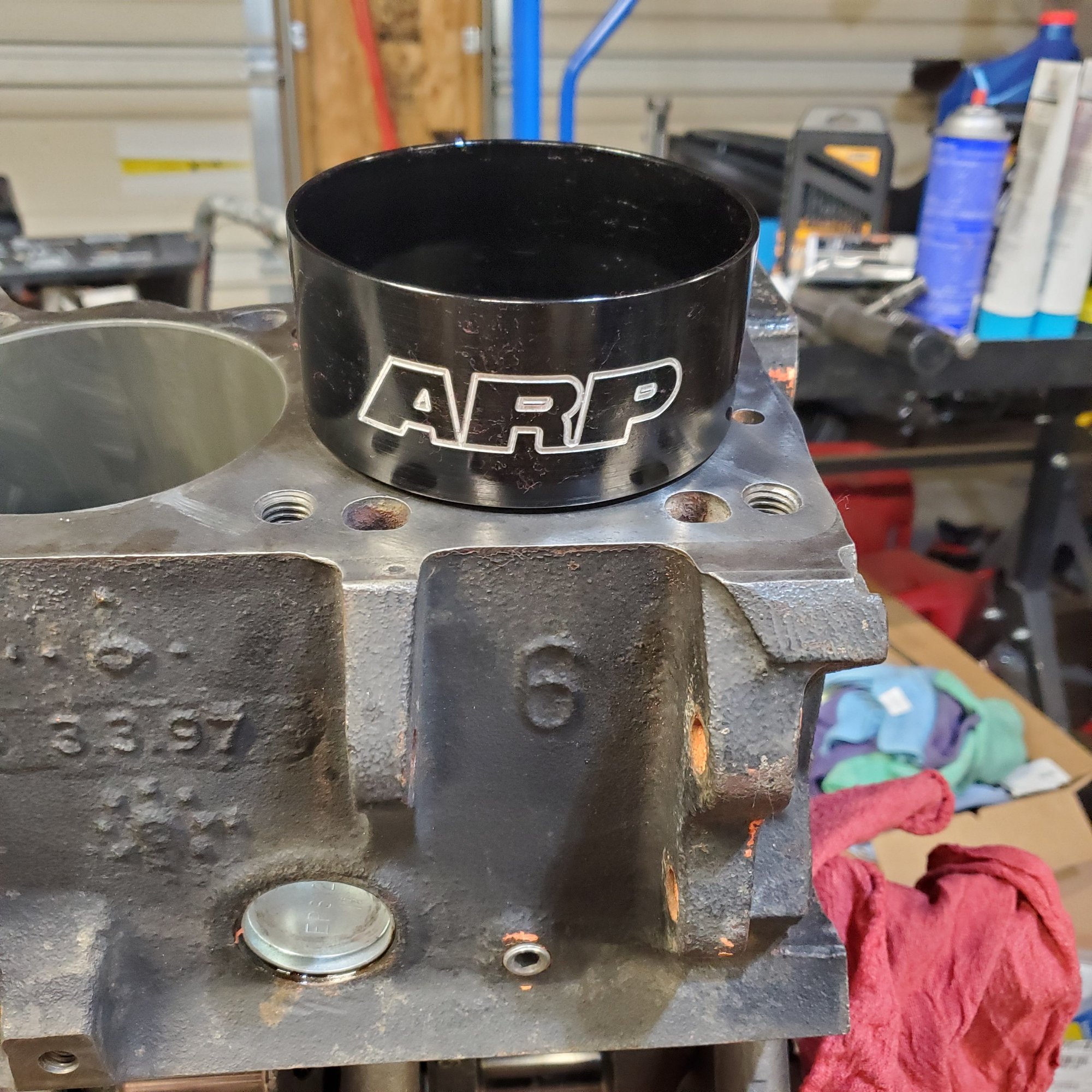

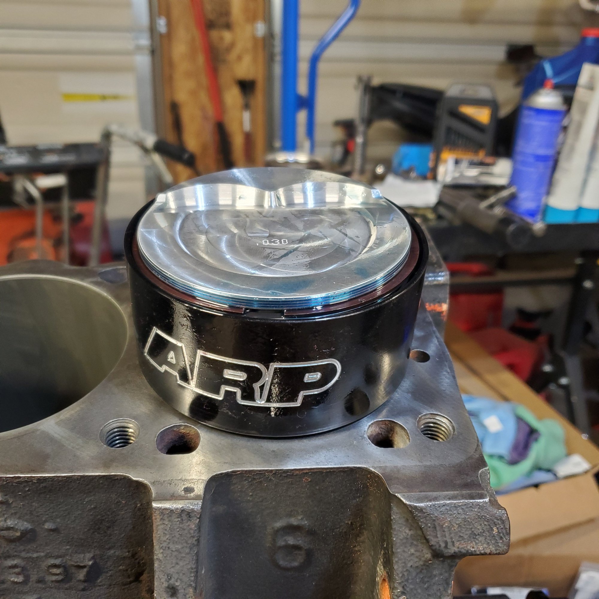

Being OLD I've used this style of ring compressor for many many years.

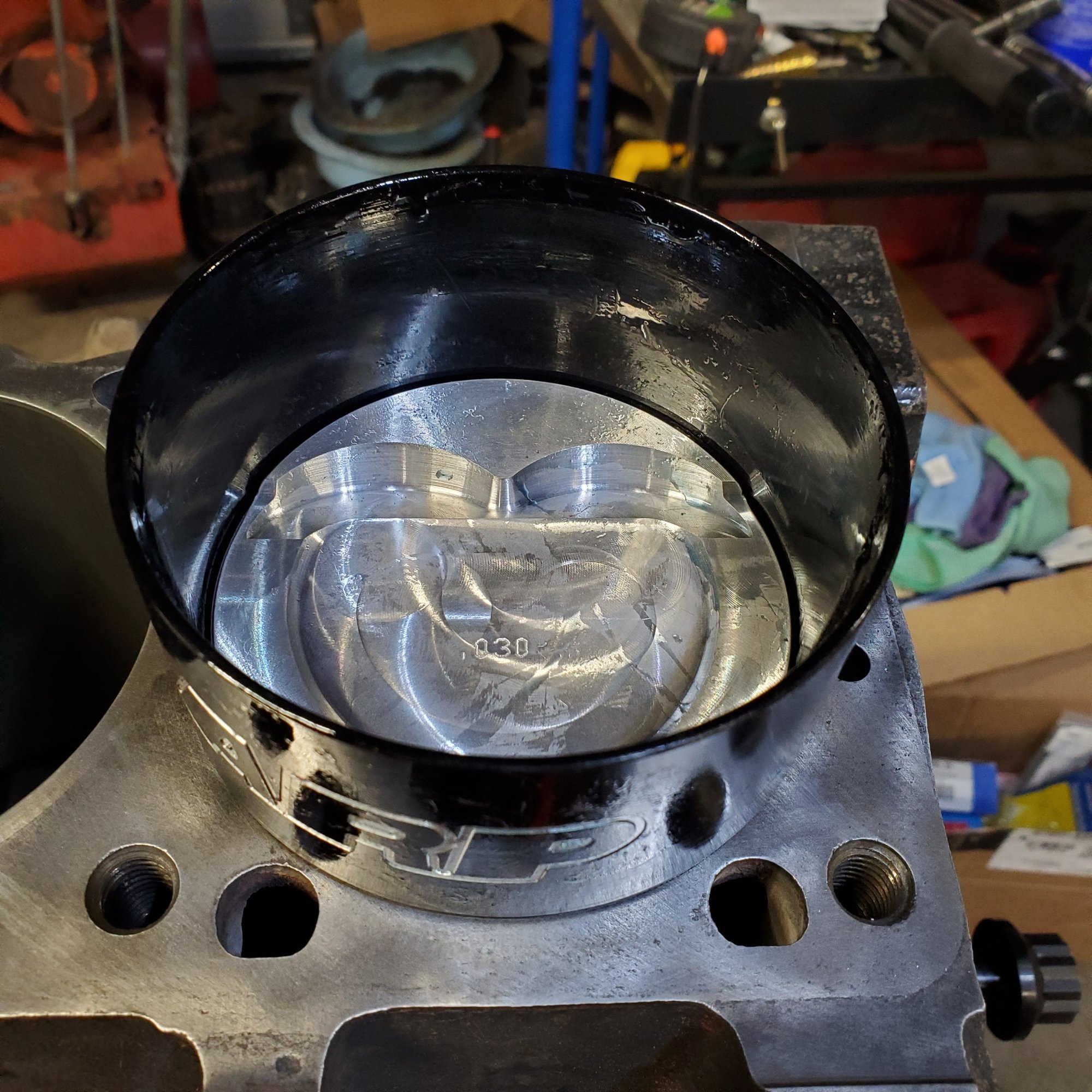

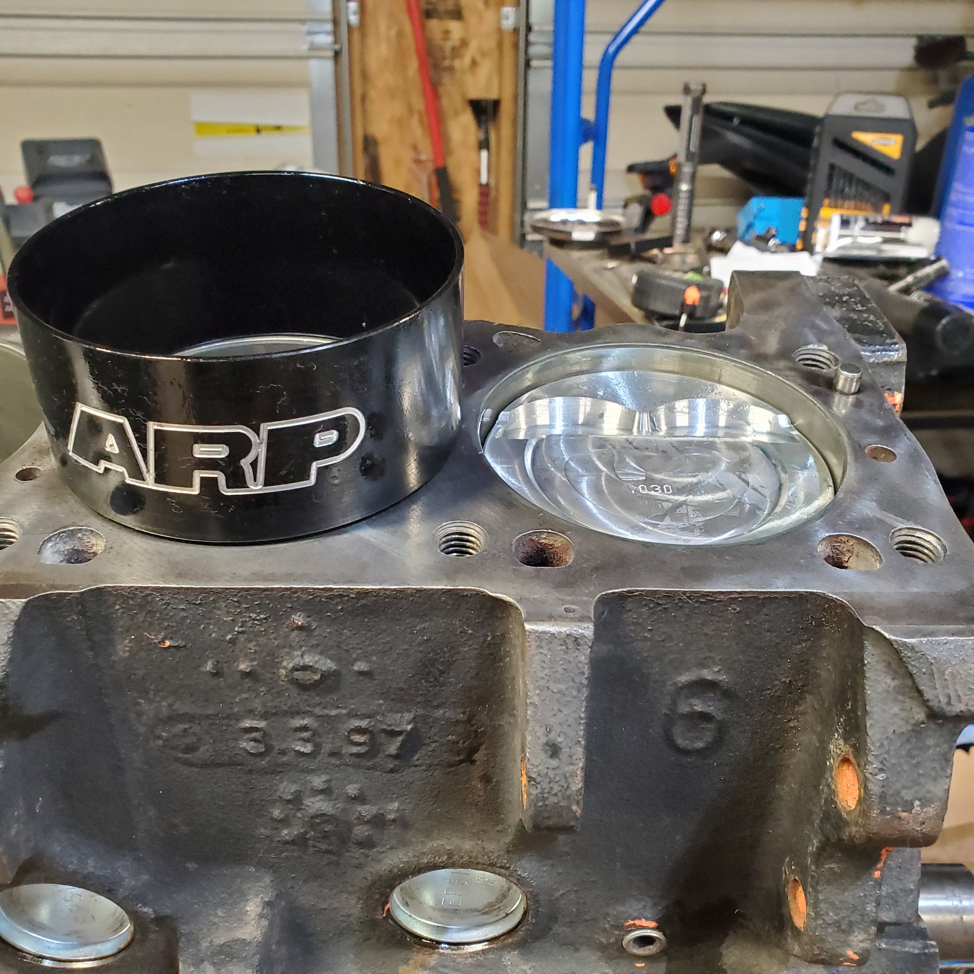

Put for this engine assembly I wanted to try a tapered ring compressor so I got this from ARP in the size that matches my bore.
They work really well and IMO it's a lot easier to use than the old style ring compressor. The only drawback that I can see is that you need one for each size of bore of the engine you are assembling.
So you put the ring compressor over the cylinder and after putting lube on the piston rings and skirt drop it into the compressor. Get the piston skirts lined up in the cylinder and push/tap the piston down into the cylinder.
Then move onto the next cylinder and do the above steps until all your pistons are installed.
All done and I got to use a new tool. What more could you ask for?

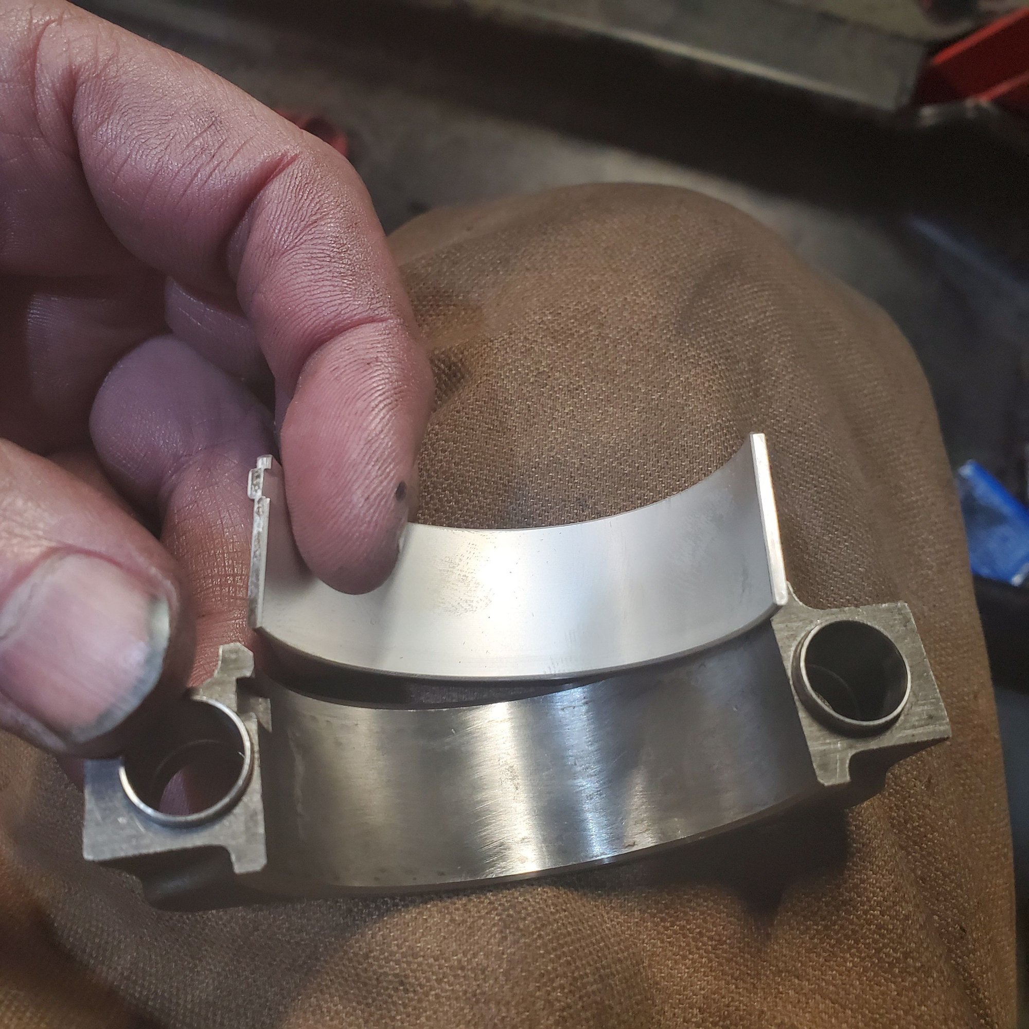

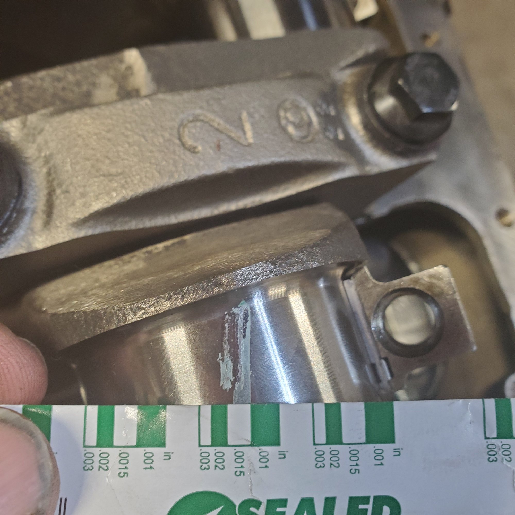

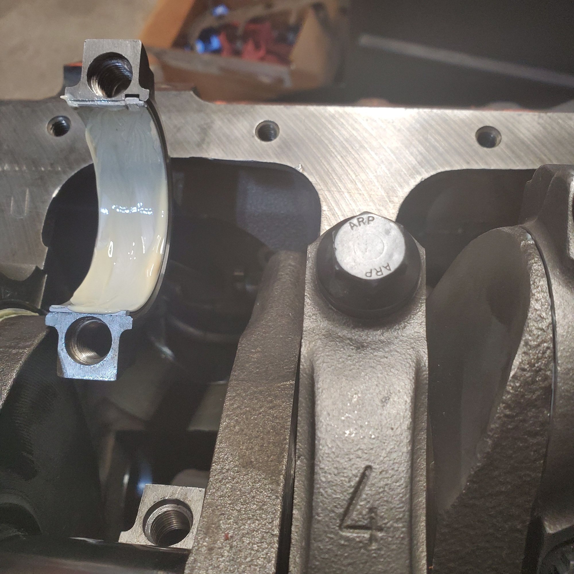

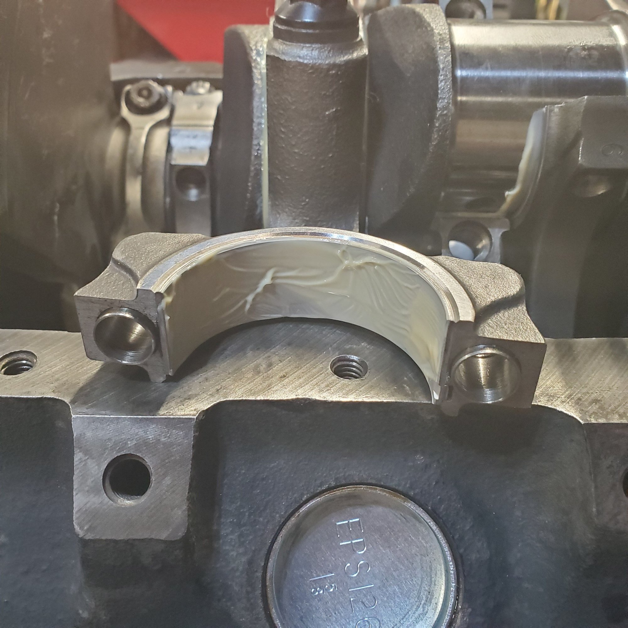

Next was the rod bearings. I first needed to PlastiGauge some of the rods to check clearances so I decided I would do #1 & #2 and then #7 & #8 rods.
So get out the bearings and install on the rods and caps. Make sure the crank is dirt and oil free before putting the plastigauge in place. Then torque rod bolts down to spec and then loosen back up and check the plastigauge to see what the clearance is.
Acceptable clearance on the rod bearings is .0005-.002 so I'm good.
After checking the clearances it's time to assemble the engine for the LAST time..... fingers crossed. So you need to apply assemble lube to the bearings on the rod and rod caps.

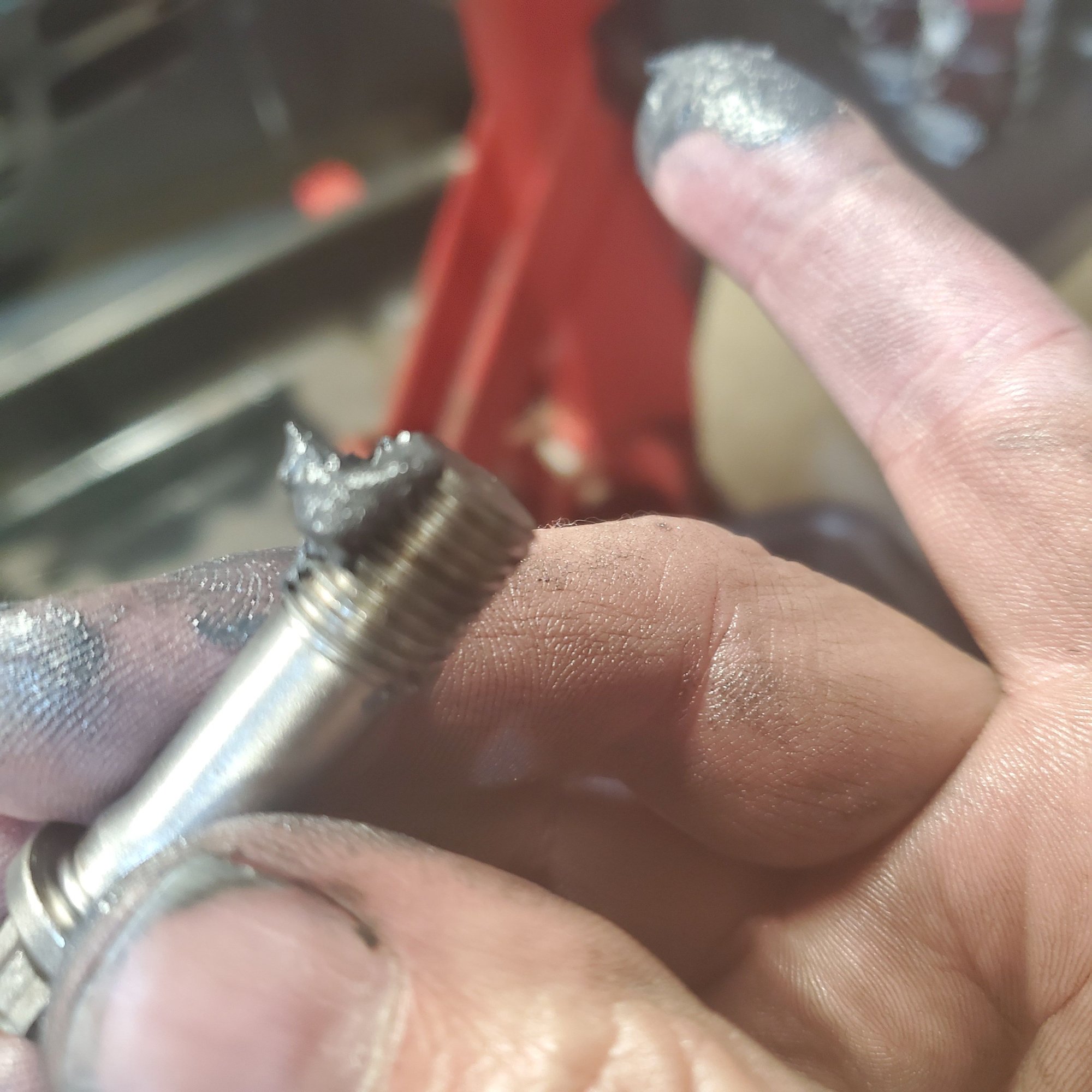

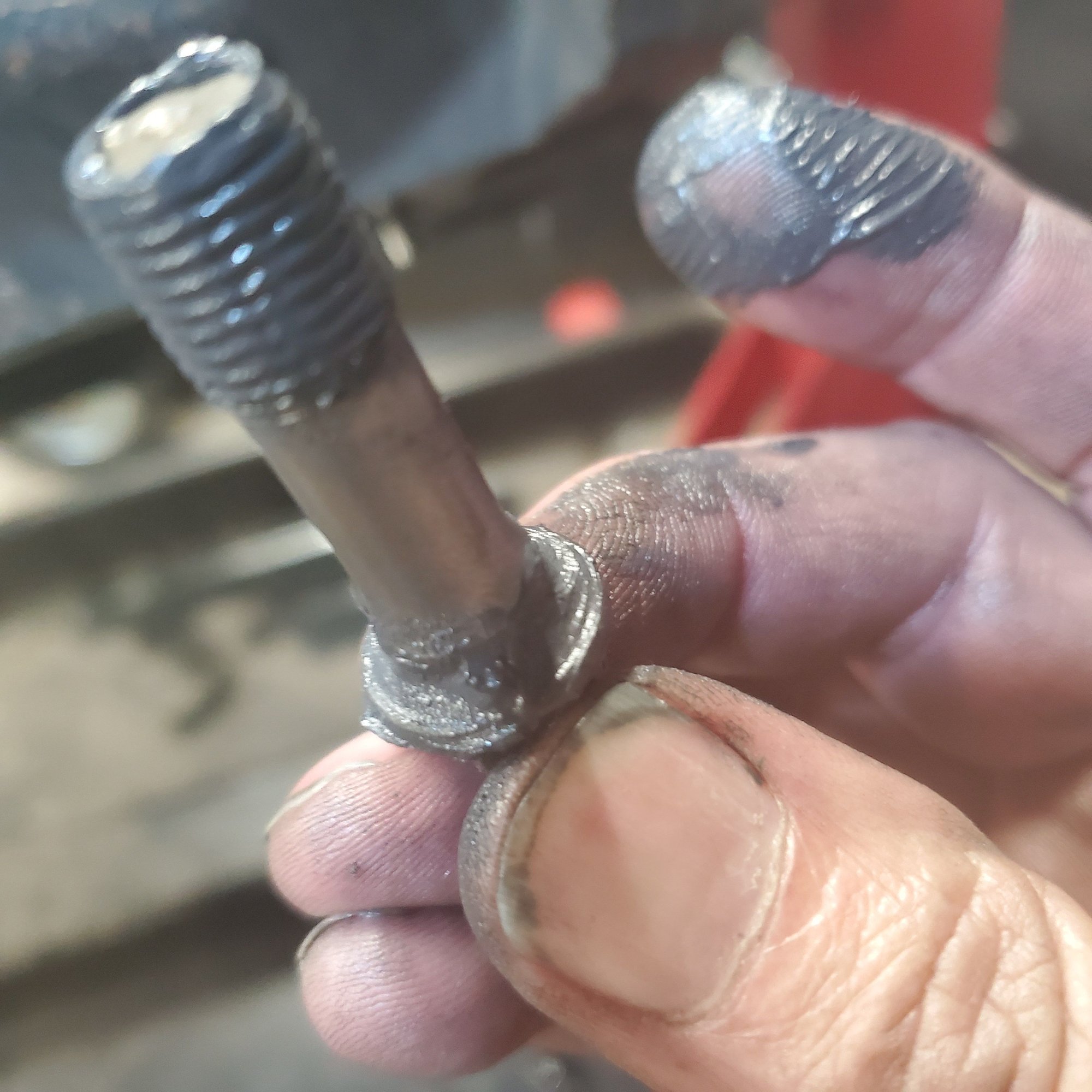

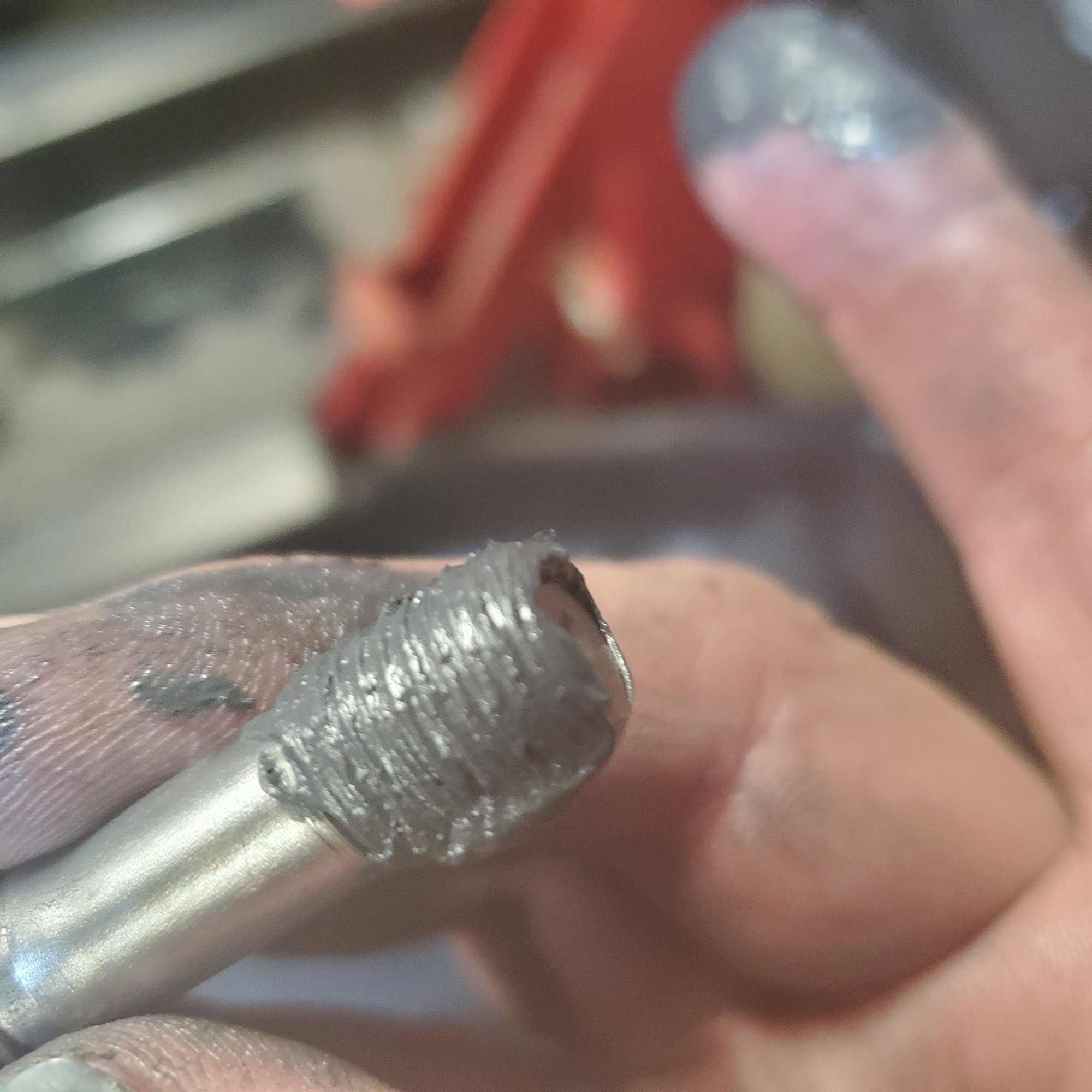

Since I am using ARP bolts on the rods I am using ARP Fastener assembly lube on the bolt threads and the shoulders of the bolts.

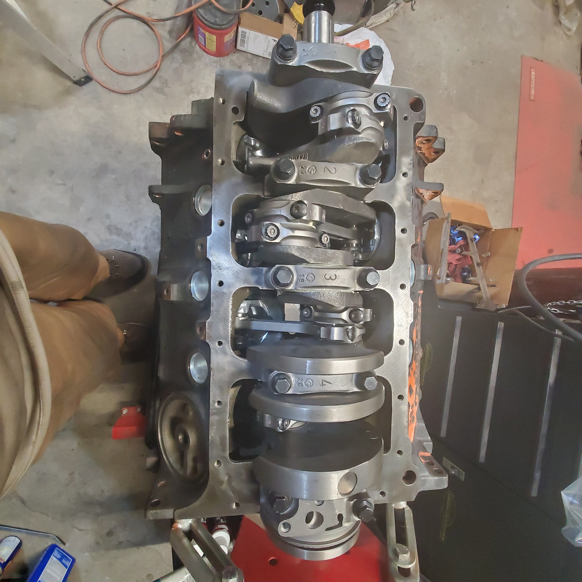

Do this 16 times and you're ready to do the final torque on the rod bolts. Once that is done the bottom end assembly is done for now.

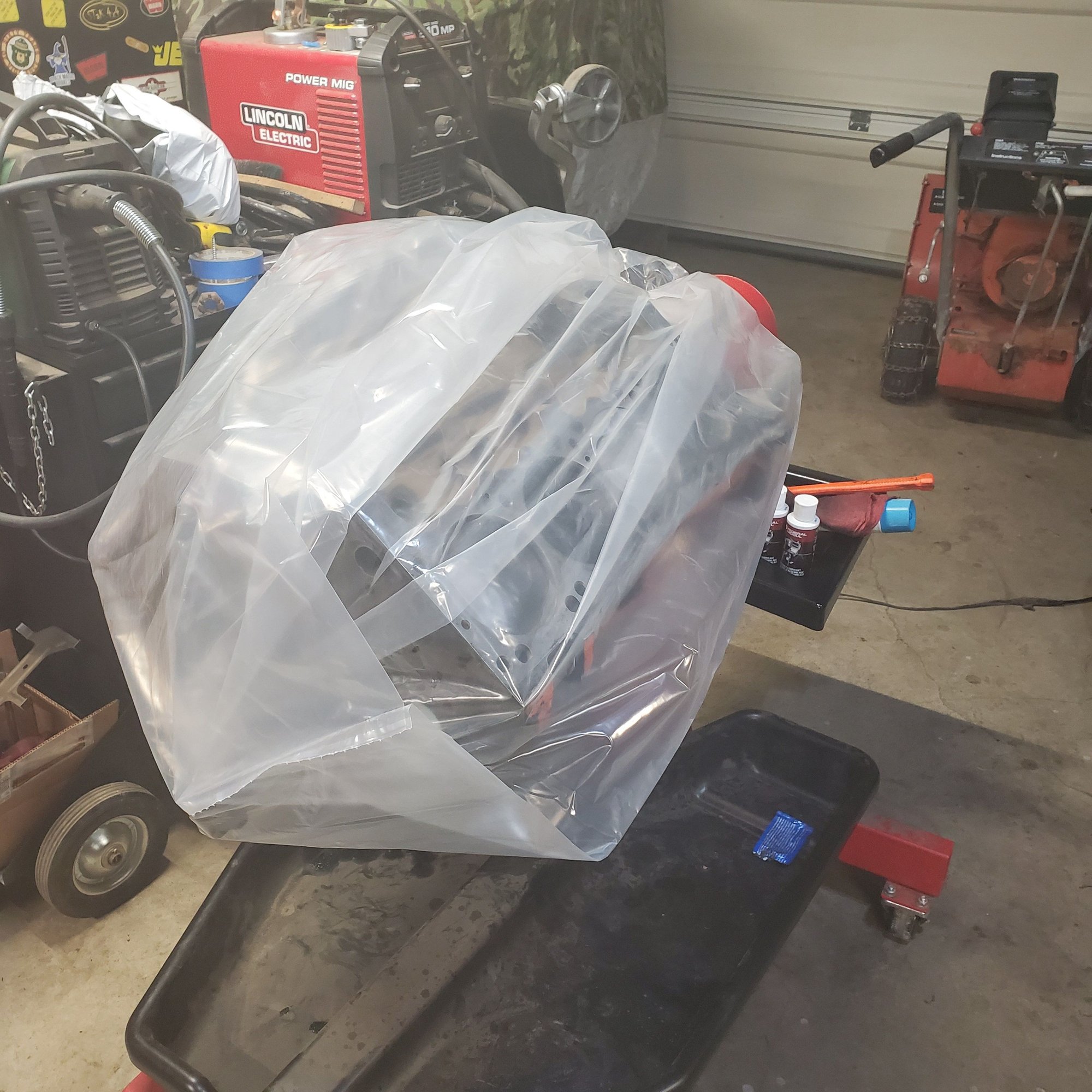

I wrapped the engine back up for the night and will work on it more tomorrow I hope.

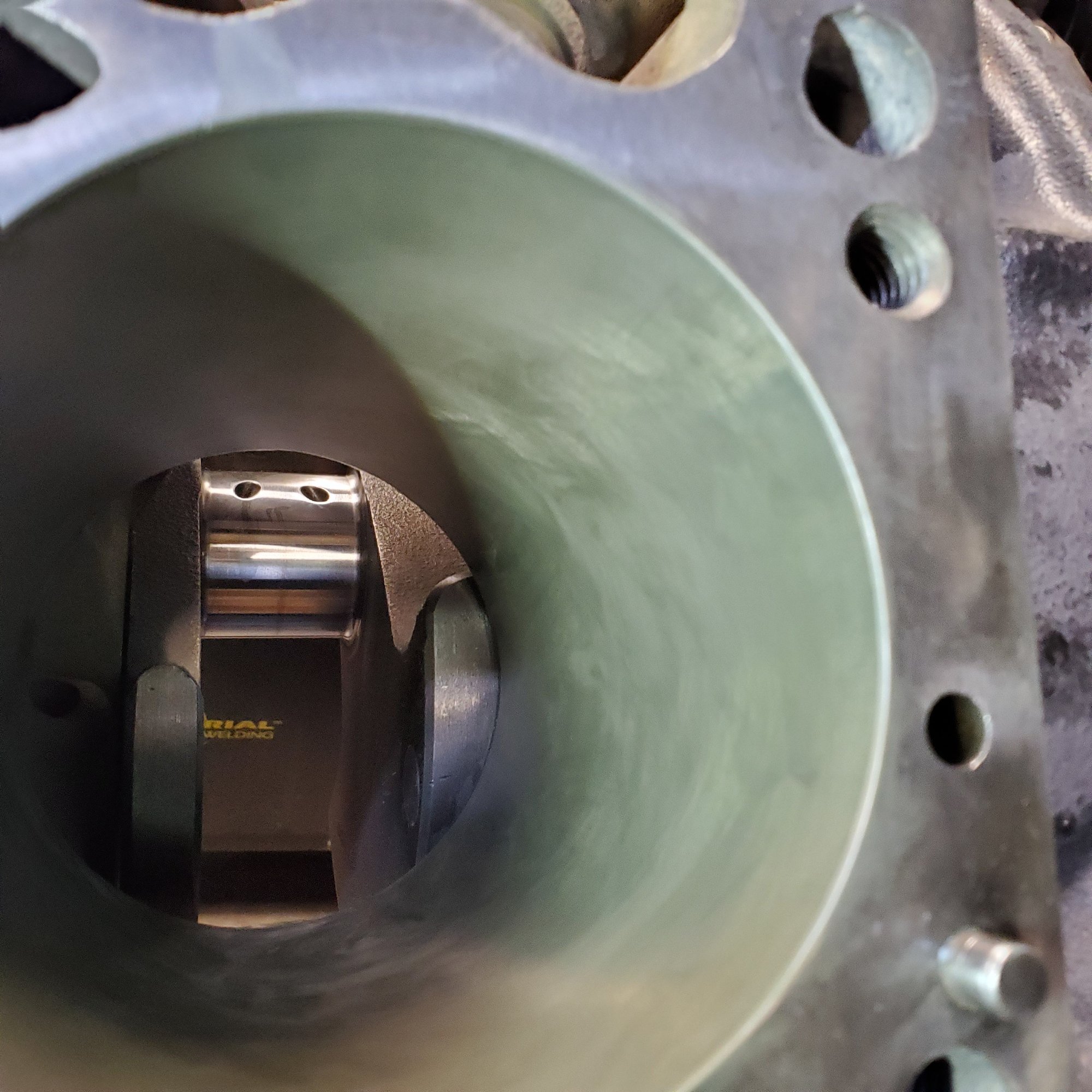

OOPS I forgot to start with the cylinder lube I got from Total Seal.
So I followed the directions and here is what the cylinder looks like before I installed the pistons.
