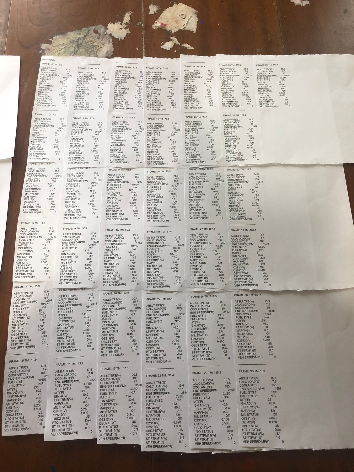

Old Apr 15, 2018 | 07:27 PM
  #34
beau680's Avatar
beau680
Joined: Jan 2015
Posts: 165

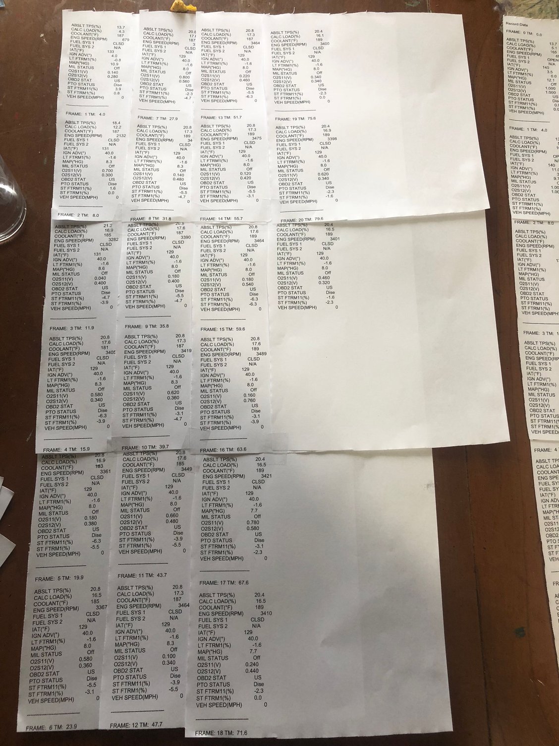

i notice around frame 15 upwards of 3000 rpms on the first photo the st ftrm is around -10 but in the second photo around the same rpm the st ftrm is around- 3. does that tell us anything?

my computer won't download the image for some reason n my old eyes cant read thes printouts. Plz resend. With that in mind, no, -10 isn't terrible on a used engine and an old vehicle with food in the gas. The good thing of note is that it went towards "0" n not higher.

Weird both images didn’t load either. I loaded 2 of them

I'm lost here, what's the problem with your having again? Bad idle...is it still bad? Those numbers look like a pretty healthy engine n your sensors seem to be saying...I'm feelin' the love. The timing advance seems to be stuck on 40 at high RPMs, but with snapshots instead of live stream data, I don't think it means anything.

Yes that was the problem truck seem to be running great now. I really just wanted confirmation that someone couldn’t see any more issues with that data. As I don’t necessarily know what I’m looking at, it looks like a pile of numbers. lol.
