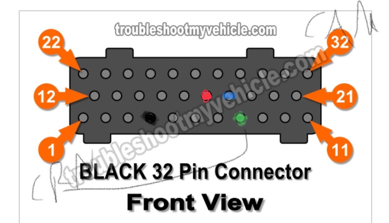

http://troubleshootmyvehicle.com/chrysler/3.9L-5.2L-5.9L/tps-wiring-diagram
According
to that page the Map should be unplugged, but if it is pluged in. Then I have a dead short to ground on the power wire, but the website says to unplug everything.
Also, no have haven't checked the slop on the chain, because I'm working by myself. However, I would imagine that I need to move the crank back and forth and see how much the distributor moves correct? I guess I could take a picture of the distributor
