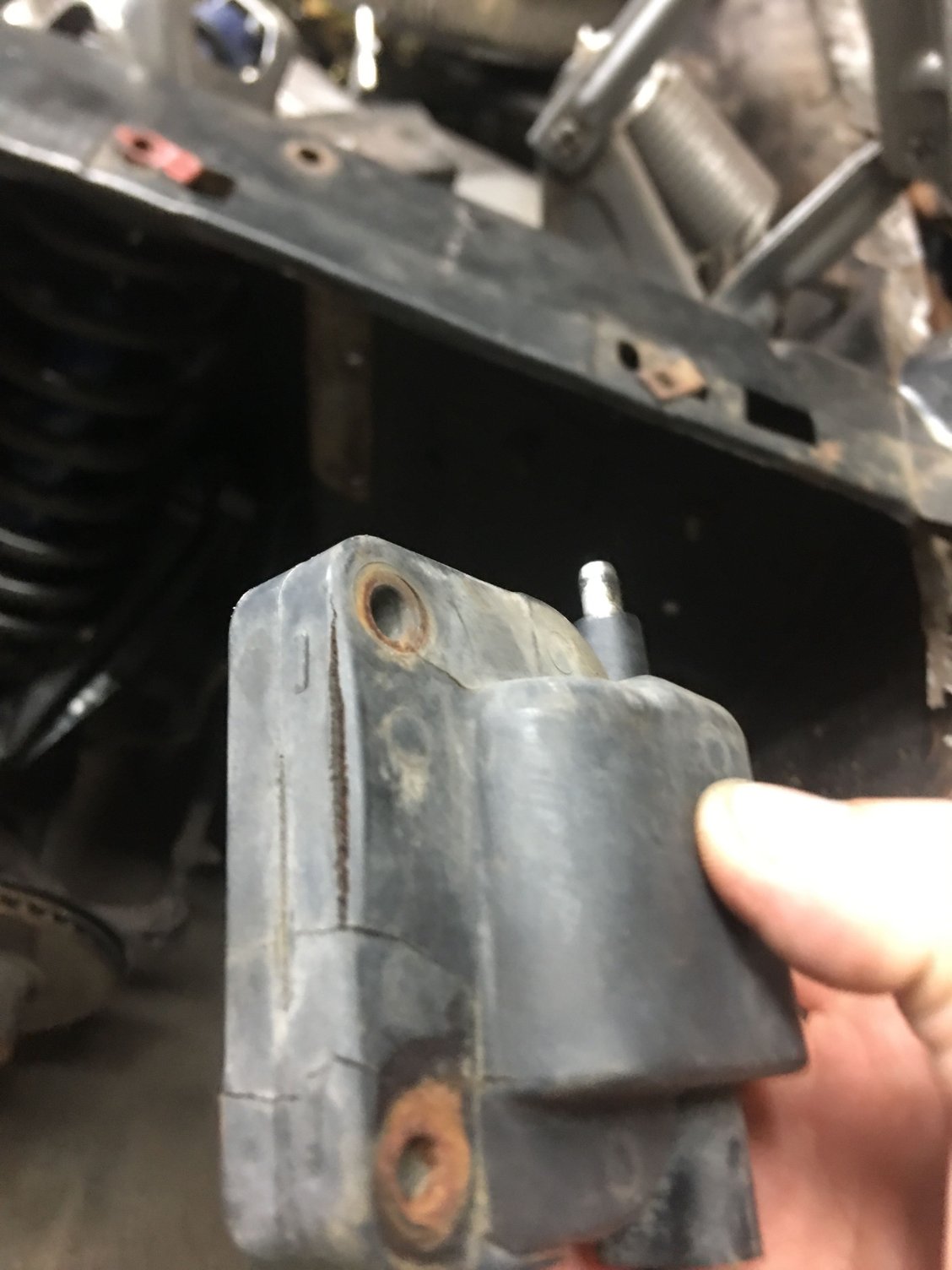

here is a picture of an ignition coil, causing a weak spark! Reset PCM, but still no good

Originally Posted by racefan41
i'm not thinking the coil would fix the code, but i'm wondering if you have more than one issue going on. I've heard bad cam/crank sensors can burn up a coil.
He ^^^^ was right about multiple issues. I'm surprised it ran at all with the broken case on the coil.

Dang, well i guess you don't need to get the ohmmeter out for that one. ^ I'm surprised that was running too, or at least throwing some random misfire code. I would get one from the dealer and be done with it. The part store ones are junk imo. Some guys might have good experiences with other name brands.that are reliable.
