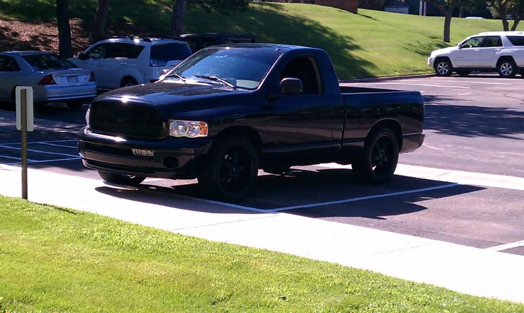

I haven't posted in a coupke years. I got some motivation back to go lower with my 4wd. Here's dodgey with a flip in the rear and adjusted torsions in the front. sorry for the bad pic
