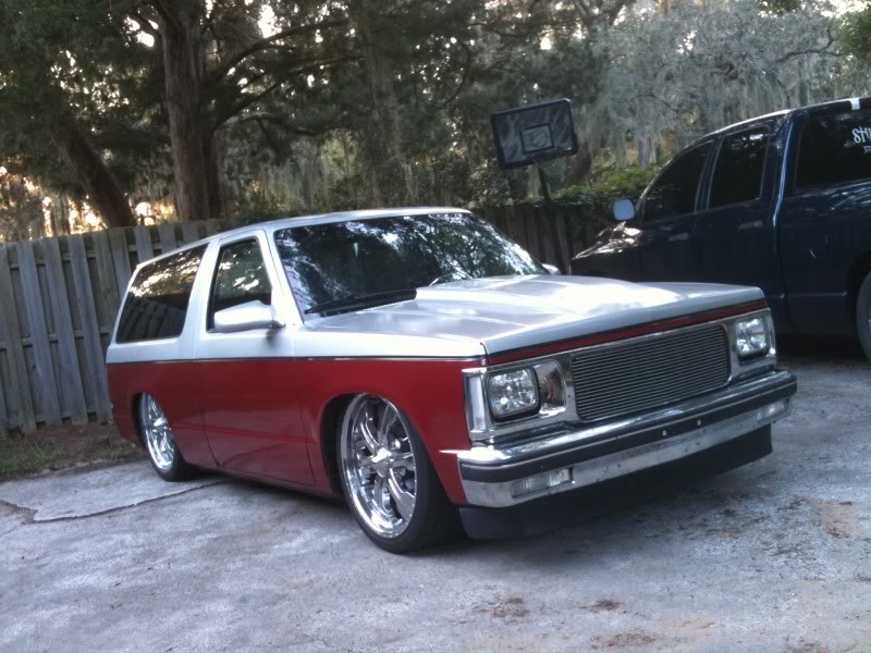

whats up ninjas!? been a while! had to get with HIDextra so while i was in the neighborhood i figured id stop by. still have the ram, she's doing great. got a new addition to the fam... a bagged 89 blazer! chevy i know... but we needed a second family vehicle for the other new addition to the family. im having a daughter due in january! thankyou thankyou. hope alls well with everyone.... gonna put yee ol DF back on my favorites list and come back more often, brush the dust off the lower class section *here's a pic of the blazer*

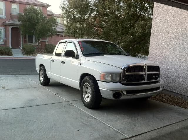

Here It is now. Probably going to go lower. this is with ebachi coils up front and belltech leafs out back
