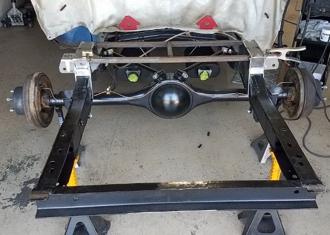

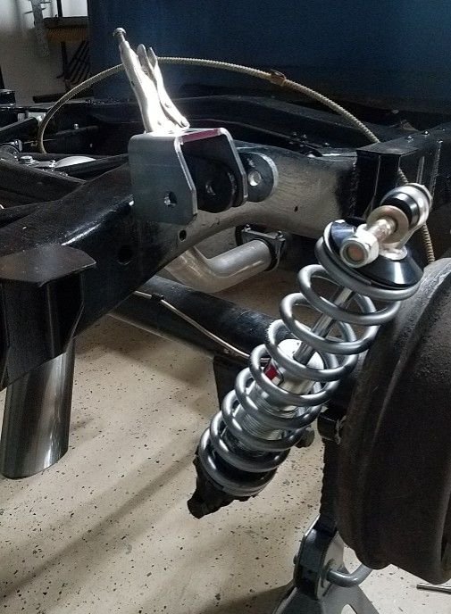

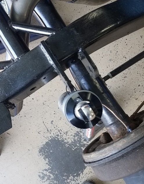

2) I think I have to install a step c-notch. Ill take a picture of this soon, but the new rear shock mounts need to be mounted in a way that the QA1 shock is about 14" installed. Thats where it is now, with the old mounts, but on the lowest hole in the bottom bracket. I want to be able to really lower this thing if needed. The new mount has a hole thats about an inch lower, that makes the problem worse. Plus I have almost 4" between the axle tube and the frame. Lowering it will make that worse. I know a notch guarantees I have to raise the bed floor or install a hump, but Im okay with that. Plus with a step notch, I can mount the upper shock mount on the notch, and use one of the higher holes on the lower mount.

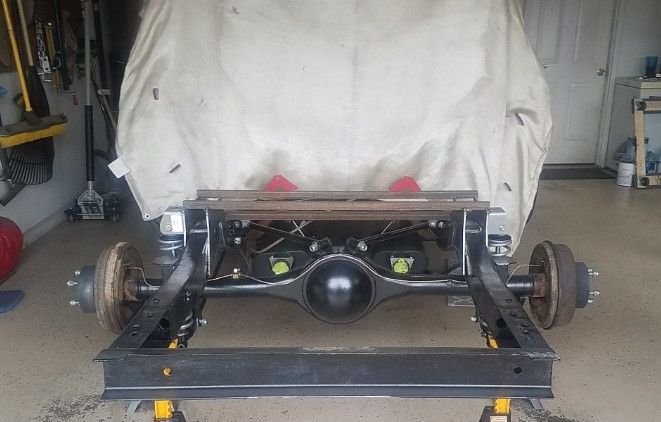

How it sits now, with everything as I originally mounted it. I might want to lower the rear a touch. I might even lower the whole truck for special occasions.

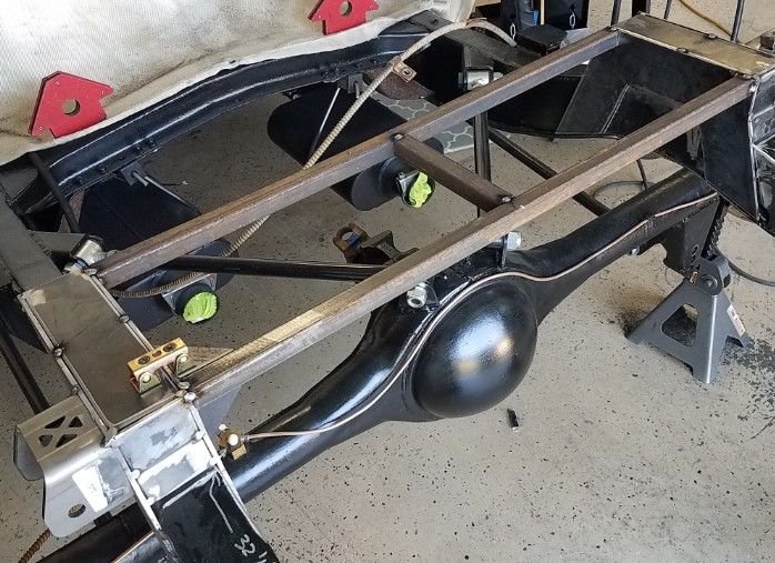

Where the upper mount needs to be, at a minimum. A notch will give me an option of a higher location, and more clearance.
This shows the upper and lower. I would like the lower to mount in the middle hole, to allow more adjustment.

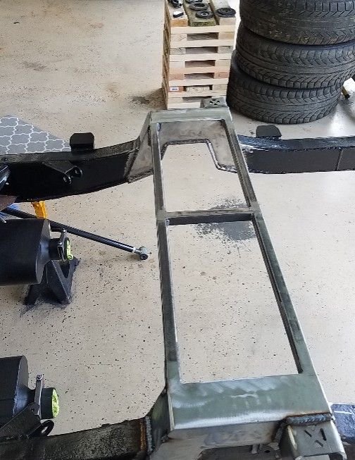

A couple of hours of grinding and the back is out. I finished the laundry room about 1 o-clock today, and went to the garage to start the modifications. I cut all the old supports and the tow hitch off, and laid out a c-notch. The upper shock mount in the position shown will give me about 15" bolt center to bolt center for the rear shock, in the middle hole on the lower mount, which is what I was looking for. It also gives me about 7" maximum clearance between the frame and the axle tube. The bad news is, this will raise the bed floor by about 3" in this area. Im going to start with a center hump, but Ill probably raise the entire floor.
All that work, gone. I should have paid attention. See the pile of metal dust in the floor?
Proposed c-notch. Ill cross brace them after install and boxing.

Got started on the c-notch. I cut all the main pieces yesterday, and made them match. I tacked them on today, and added the square bars in the pictures. These are sort of temporary. Ill use them to hold it all together until I get the top side welded together. Ill weld the notches on the frame, then cut the bars out and move them down, then Ill cut the notch out of the frame. The square bars will tie the sides together. They are about .100 to.120 wall 1x1, so they will be nice, and itll give me a flat top on the notch. I might not have enough of the 3/16 to finish the notches, so I may have to get more. I also need some 2x3 .120 wall box beam to lower the hitch. Im on overtime at work now, so itll be slow for awhile.
Tacked in and looking good to me. Shocks are just hanging for now.
The bars will be dropped down and tied in after I box the top.

A little further on the notch. I got the top plates tacked in, and the cross braces tacked in. Im not sure how to brace this. Im going to look at some pictures online. I made some gussets for the corners, but Im not sure if they are enough. I have more of the square bars so I could make corner braces out of them. I can get more of the bar and triangulate the top bars. I can get round bar, and do something with it. Im just not sure. Tell me what you think.
Next, Ill remove this as an assembly, and cut the top of the frame only. Then Ill re-install it, square it, and weld it. Then I can cut up from the bottom and meet the top cut, and the notched piece will be out. Then I can cap the bottom.
Everything tacked in. If you look closely, you can see the little gussets. Not sure if Ill use them.
Bottom left hand corner of the picture is the gussets. One is held in place with a magnet.
