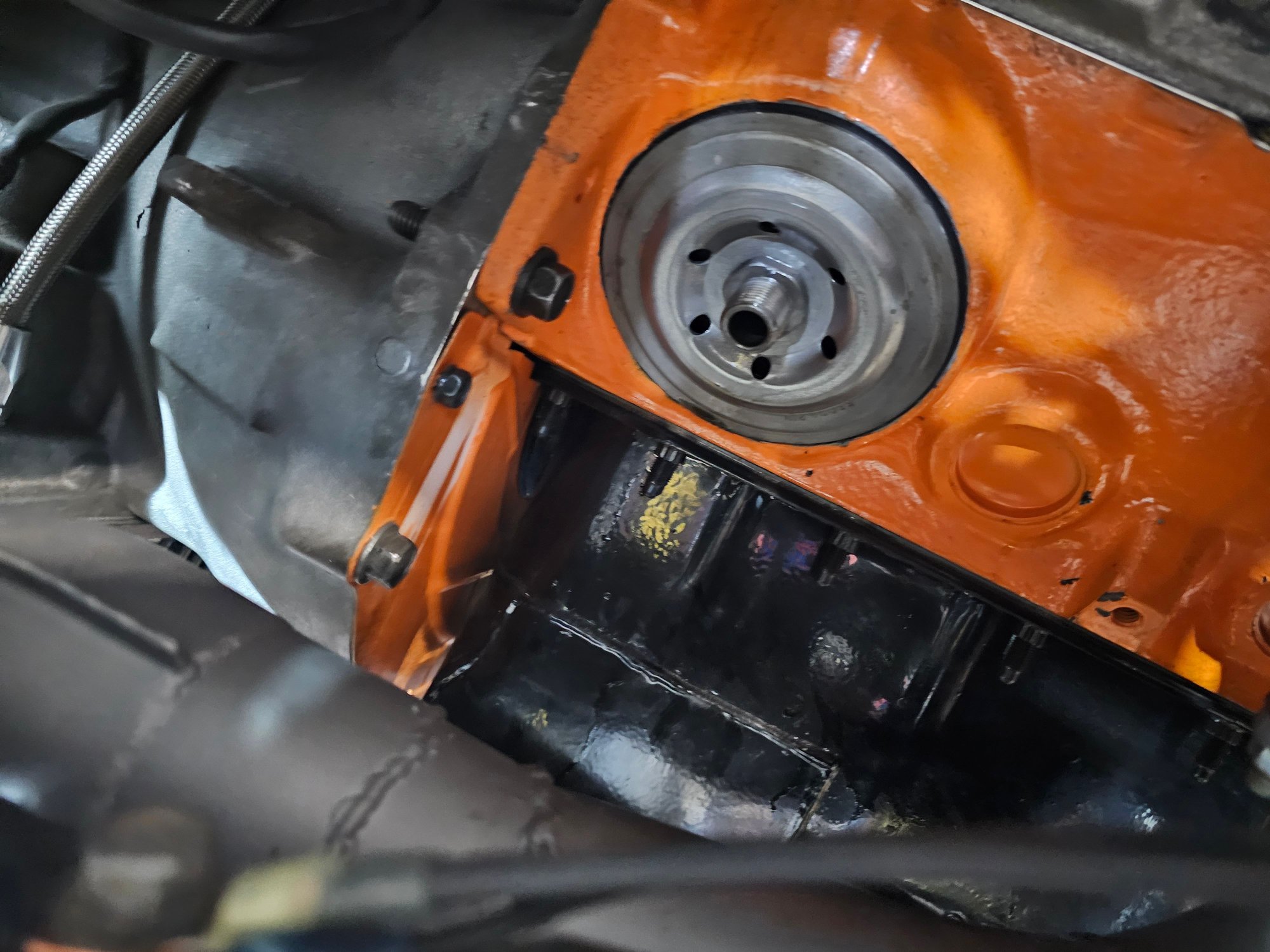

Is this the correct way the oil filter housing is supposed to be setup? I just had a HECK of a time trying to get the oil filter back off. So I'm wondering if I've got something setup wrong.

I have had filters that were VERY reluctant to come off...... usually the result of someone over-tightening them on installation. I usually just put 'em on hand tight..... (sometimes both hands....) and they can STILL sometimes be real fun to get off......

Not putting lube on the seal before installing can also add to the difficulty removing them in the future.
Originally Posted by HeyYou;[url=tel:3571479
3571479[/url]]I have had filters that were VERY reluctant to come off...... usually the result of someone over-tightening them on installation. I usually just put 'em on hand tight..... (sometimes both hands....) and they can STILL sometimes be real fun to get off......
