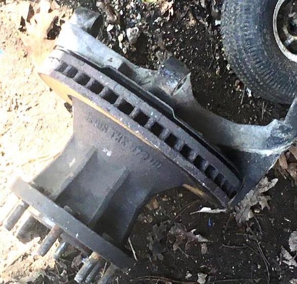

Experienced a first for me last weekend - complete failure of the left front wheel bearings to the point that the bearings are seized to the spindle. I just replaced and repacked the bearings not long after I got the truck so I know how long it's been since they were last serviced. The most perplexing thing about it is that I've been packing wheel bearings for most of my life and, until now, never had one fail like this before. When I popped the dust cover off, it looked as though they was barely any grease in there at all and I'm not cheap with the grease when I do them. A quick inspection of the right side shows everything pretty much as I left it. As much trouble as I had with the "shop" that put the tires on it and messed up the alignment a couple of months ago, I can't help but wonder (and really hate being that suspicious) if the left side didn't get a little help along the way.
After spending a couple of hours trying everything short of a cutting torch to get the rotor off last Sunday, I decided it wasn't worth trying to save the rotor. I ordered new rotors and pads online (needed new ones anyway), picked up new bearings and seals for both sides, and obtained a replacement spindle from a parts yard down the road. I got notification the the rotors will be here today so as soon as the sun is up and things start warming up a little, I'll be out turning wrenches.
That there's one heavy chunk of steel...
